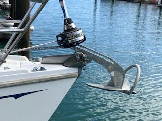

My Ancor , when launching or bringing in slams the underside of the fuller.
Can anyone suggest a bow roller that would stop this from occurring

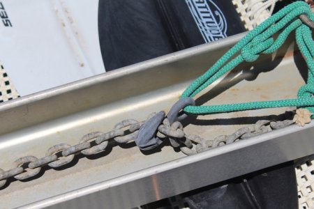

An alternative is to stop retrieval 'just' before the anchor arrives at the bow roller and then retrieve by hand. You will then have a length of slack chain and need a short strop and chain hook to hold the anchor against the bow roller - this procedure means you are not over stressing the windlass as the anchor passes over the bow roller. Deployment is the opposite, release the hook on the strop, have the anchor dangling freely and then deploy as usual. It also means you are not using the windlass to hold the anchor when at sea (which again stresses the windlass, unnecessarily). The same short strop and chain hook can be used as a 'snubber' for the anchor when deployed and then the windlass takes no snatch loads, they are taken by the strop, though you will of course be using a proper nylon snubber, and the strop is simply the back up.
Here is a picture, you need to use your imagination to convert to your bow roller.
The windlass is to the right and the bow roller to the left. The anchor has been retrieved from just below the roller by hand and then secured with a short strop and chain hook, leaving some slack chain. The anchor is now secured independent of the windlass and retained by the strop attached to a strong point (could be a horn bow cleat, in this case the aft end of the bow roller).
Its cheap and simple (you could add the strop and hook in 30 minutes) - but you need to alter your anchor handling procedures.

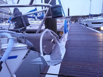

Hello and welcome to the forum.
I upgraded the bow roller to this then changing to a modern anchor. It gives far more protection to the hull.

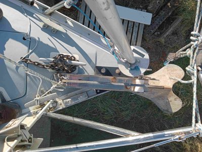

here's the actual installtn. after the pdf in #6 .
It's the Lewmar ........0008 which is only 80 wide which helps and would be about half the price of a custom .
