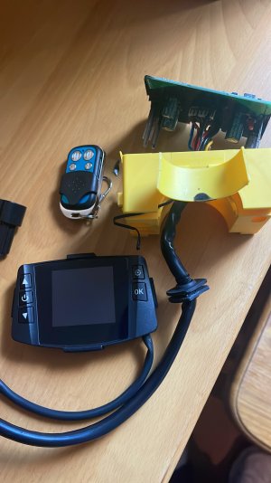

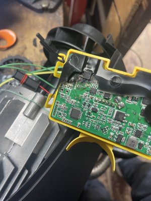

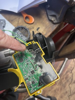

Hi. Bought one over a year ago but only just tried it (so out of warranty)). The motherboard stated smoking and turned black so now knackered. I blame my self for using a very old battery charger for the 12v supply - my fault. But ….a replacement from China is nearly £70. There’s loads on eBay but none look the same (as photo) . Wondering if other cheap set ups will work. I’m happy with basics on/off and temp. Any comments appreciated

EBay is full of replacement boards and control panels, often sold as a matching pair. I’d be careful not to buy the wrong wattage, 2kw 5kw etc. They will all likely have the same hardware but will have different parameters programmed in.
I have 2 of the 2kw heaters, one small and the other the common 5kw size but detuned to 2kw, and I have used both control boards on both sizes.
