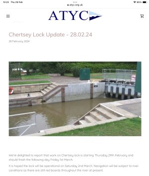

Can't find the link, but the latest from the ATYC was that a contractor has been appointed and work is starting, should be completed by the end of March if not sooner.

The ATYC announcement did not reference anyone from EA.
I have contacted Peter Collins - the EA manager responsible for the repairs -
His response was:
Following the initial closure of the lock and commissioning of an emergency works contractor, we began to detail the scope of works required to fully understand why the breakdown had occurred and also the extent of any required refurbishment works. Our project team have also been developing the necessary actions, prior to mobilising to site, which included a temporary dam design to enable the lock to be dewatered. Unfortunately, due to the competing priorities across our supply chain and the impact of the recent storms, we have not been able to mobilise to site and commence the works that we initially intended to complete prior to Easter 2024. I have therefore reduced the scope of the emergency works to focus solely on the anchor plate and its securing bolts, to enable our customers to re-use the lock at the earliest opportunity.
Our main contractor has engaged a specialist supplier to strengthen the elements that have failed, and I have requested a revised completion date from them. As soon as this information is available, I will share it with our customers.
EA Thames do have their hands tied as they have to use the National Contractors - who are just a little busy with other flood related issues this winter - but there does seem to be a plan to bring Chertsey back into service soon.
