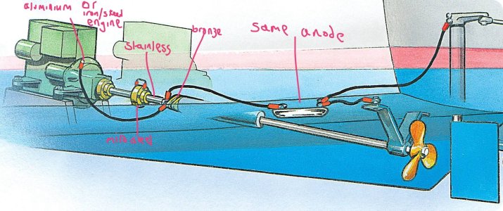

Cathodic protection. Never really given it much (enough) thought and just reading MGDUFF 's resources and saw this:

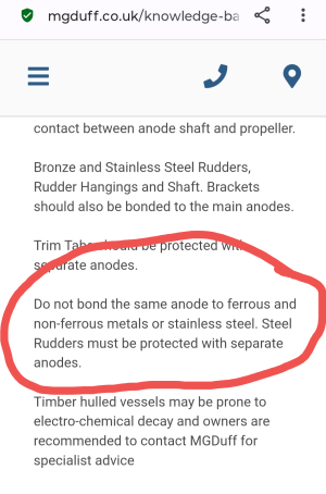

"Do not bond the same anode to ferrous and non-ferrous metals or stainless steel. ... must be protected with separate anodes."
Which is at odds with their diagram.
Do people really have multiple hull anodes to match the number if metals bonded? Or is it only the saline-bathed ones? Even so, that's still bronze and stainless.
