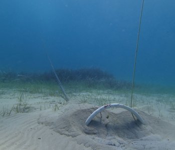

This photo was taken as I was setting my Rocna with the engine reversing at 2500 rpm. I now know that this is matched almost exactly by wind strength force 6.
Although I am well aware that the chain is not exactly straight, it is visibly very close to it. This was in a depth of 4-5 metres with a scope of around 4:1. Catenary is just about non-existent.
Photo taken by noelex's 'mermaid'.

This explains perfectly. As I said in my initial post there will always be a small amount of sag but it provides absolutely no elastic effect. Most would say that the chain in my photo, and the fabulous one by Peter Smith, is straight.
So a the sag on a catenary approached zero the horizontal forxe will approach infinitary
so the theory says you will never get a truly straight anchor chain ass the load will exceed the chain breaking oint before the chain becomes truly straight
That's fine if you're a mathematician. For sailors relying on the catenary to reduce snatch, Viv's photo is plenty straight enough to give 3/5 of sfa shock absorption.

The photo illustrates how with any reasonable wind, the catenary for all practical purposes disappears unless you anchoring in very deep water.
The catenary does have some role to play when initially setting the anchor. In the early stages of setting when the toe is starting to dig in, the anchor will have little holding ability and catenary or chain weight will help in keeping the direction of pull parallel to the seabed. This early stage when the anchor is just penetrating the seabed is important.

"This photo was taken as I was setting my Rocna with the engine reversing at 2500 rpm. I now know that this is matched almost exactly by wind strength force 6."
How do you know that? No offence, I'm genuinely curious.
Hours of observation using mask and snorkel. I have many photos too, so rewarding in clear Greek waters. Some here Oversize anchors – necessary? although not actually in F6 winds

There is data on the load applied by a boat in reverse - good source is the YM test on propellers a few years ago. A boat and engine combination like Vyvs (and mine) with a 30hp engine achieves a pull in the region of 250-300kgs. Varies according the the prop, but his Bruntons, my Flexofold on my last boat and Featherstream on the current, all with 30hp achieve near the top end of that. A 3 blade fixed would be similar. Data on the loads in relation to wind speed for different kinds/sizes of boats you can get from a number of sources, principally the ABYC and directly from empirical data such as the Practical Sailor tests which show similar loads in the speed range 25-30 knots (F6/7).
