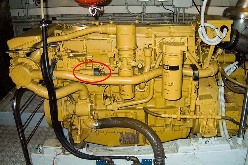

Here's how it looks like on the 3116.
I guess it's neither much different nor far from that placement also in the 3126, but I can't be positive about that.
The red button on the right side of the cylinder is the manual stop, btw.
I can confirm its identical on the 3126
No edc or electronics of any kind on this engine .
I'll have a look and come back to you ….. thank you for photo
