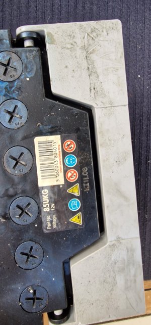

That was it! Still pretty warm to the touch, even after several hours without charging - I thought the heads was a bit smelly yesterday, but must have been this.
Any recommendations on a replacement? I guess it needs to be pretty heavy duty given how much umph the bow thruster uses.
View attachment 174053View attachment 174054
That is a Flooded Lead Acid Battery which needs the cell electrolyte level maintained with Distilled or De-Ionised water. Given that you were unsure of its location I bet it is bone dry!!🥴 It is marked 85UKG. I reckon it is 85 ahr. I would suspect that that Paul R. would recommend an AGM replacement. What is the power rating of your thruster?
