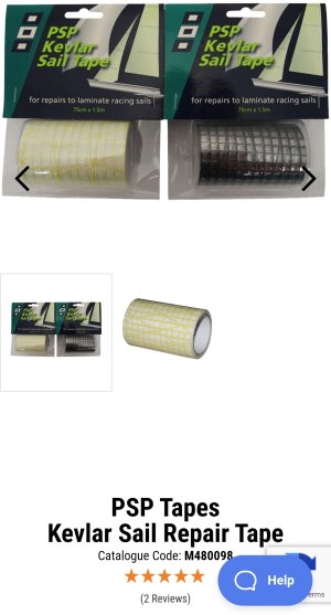

The challenge is that even the best tape-type self-adhesives (3M VHB tape, for example) are limited to 10-25 PSI (Google it) prolonged strain before they begin to creep. For example, Kevlar sail repair tapes have to have the edges held down with polyester SA tape or they start to peal. The carbon adds some stiffness, but it is really not much stronger because of the SA limitation. If you think about what SA is (gummy, non-drying) it cannot be otherwise.
