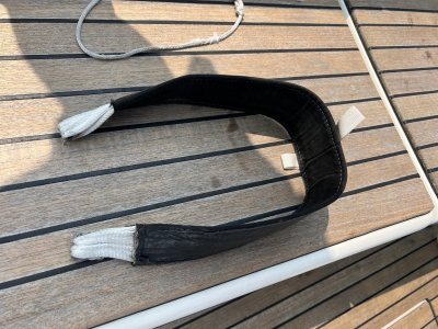

I race on an XP44 with a carbon boom.
North Sails made some sailcloth and webbing straps for just this purpose.
There is no adhesive or anything even semi-permanent.
I have not noticed any wear or chafe on the boom.

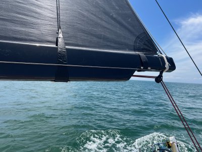

it took a few days, but here are the pics.
the 1'st reef strap stays in place because pf the boom shape.
the 2'nd sometimes gets lashed to something aft so it doesn't slide too far forward.
there is no visible wear on the boom.
