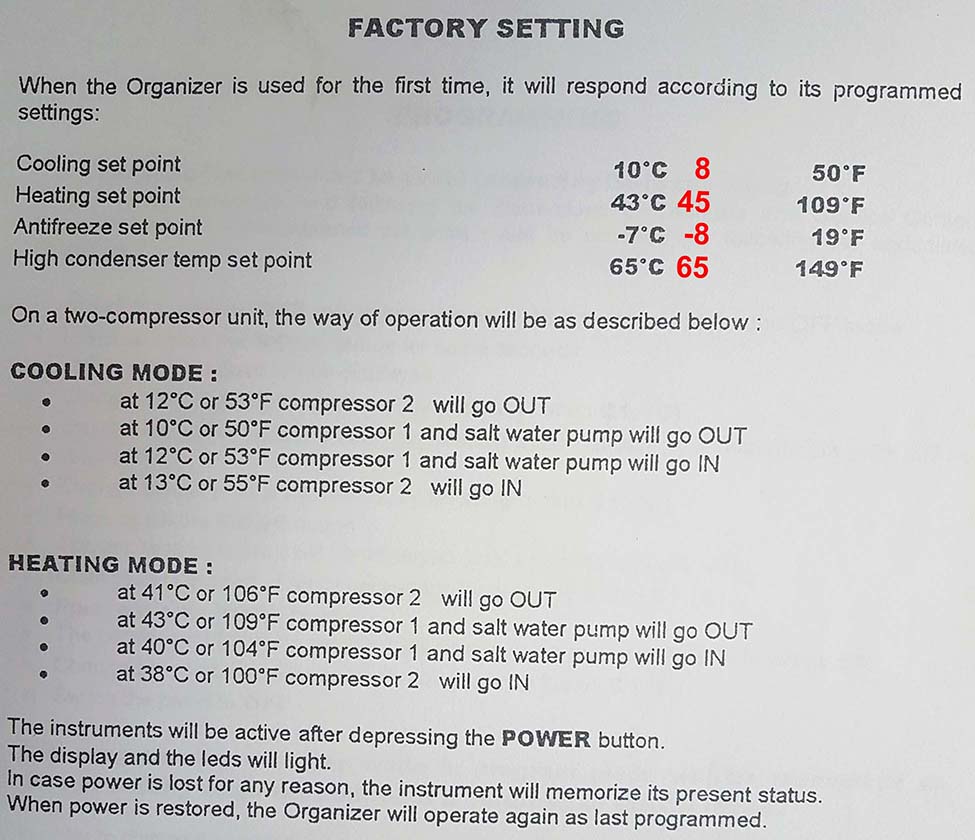

Mike - I have a Condria system too it also cuts out at 10 degrees and back on at 12.5. I was looking at the manual the other day and I recall mention of these settings. I'll dig them out in the morning and let you know
Hi Mike
Here you go - hope this helps
It sure does, many thanks for sharing those pages! :encouragement:
If it weren't too cheecky, I'd be tempted to ask you to post also any other pages which in your opinion are worth having, for those who have the same equipment... :o
Anyway, fwiw, I just checked my system (PCWM/FCL 9002, 2004 vintage), and got the slightly different results below (in red).
I can't swear that the system came as follows from the factory, but I'm very skeptic that anyone ever messed with it.
I would rather guess that Condaria checked the first installation on each boat model of the yard, and then slightly adapted the settings for future supplies of the equipment.
For the records, the panel doesn't show the other set points (i.e. 12 and 13 for cooling, and 38/40/41 for heating), so I can only suppose that they change consistently with the base set point - i.e. if my system goes in standby at 8 rather than 10, it probably starts again at 10 rather than 12, but I can't be positive about it.

Anyway I have learnt today that the 10-12.5 degC cycle is correct - see next post:D
Special thanks here go to farsco and markc for their assistance
On farsco's recommendation, I did email Edd at MBS and he is indeed a super helpful guy. He has sent me the user manual for my particular Condaria unit and confirmed that whilst earlier Condaria units did operate at lower temps, my particular unit is designed to cycle in the 10-12.5deg range and therefore it is indeed correctly set up and there is no scope for reducing the temp of the chilled water
And also many thanks to markc for posting pages from his Condaria manual which also confirms a similar temp cycling range
