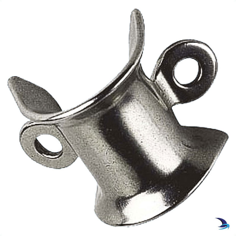

Just need to fit a deflector on the halyard slightly higher than where your cap shroud enter the mast or use a block off that eye I can see.
Doh! Why are answers always so simple and obvious, just after somebody else has pointed them out...... I think the deflector will give a better angle than the block, unless it is a very small block.
Thanks Javelin! That might be tomorrow mornings project then! Have to see if I can find a deflector locally.

I fitted a halyard diverter to the mast. Which results in a perfect furling action.
