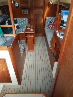

We got two sheets of the holly and teak laminate from Robbins - Marine Plywood & Panel Supplier UK
The saloon sole is made up of 12 ply panels, a real pain in a*rse to take up and like Jenga to put back down. The plan is to make some larger but manageable size panels then when cut and shaped, apply the 2mm laminate. It looks great and has a slight non-slip texture, there is a sloped part of sole in the galley and I'm confident I'll be able to heat the sheet to form it and bond it.
Maybe worth a look and fir your purpose 😊

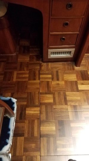

We did our own parquet using teak blocks about 7mm thick. Also added some matching shelf fronts as well. Was a labour of love but worked out really well. Before varnishing, we added two coats of clearcoat epoxy. Sand it flat then varnish with 3 coats. It's super hard wearingreceived_961493035091724.jpegreceived_144520295333650.jpeg
We did our own parquet using teak blocks about 7mm thick. Also added some matching shelf fronts as well. Was a labour of love but worked out really well. Before varnishing, we added two coats of clearcoat epoxy. Sand it flat then varnish with 3 coats. It's super hard wearingView attachment 160481View attachment 160482
I did the same but it was a disaster as they all swelled in the winter and cracked up, despite numerous coats of sealer.
