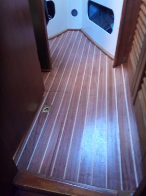

It is however possible to create a similar effect by using normal WBP (12 or 15mm depending on how large the panels are) and gluing on strips of teak veneer like this thewoodveneerhub.co.uk/collections/constructional-wood-veneer/products/teak-constructional-wood-veneer Needs cutting to the desired width and sticking down leaving a 4mm gap for caulking (cream would be good). Photo shows similar laid on the coachroof of my GH. For floorboards would need sanding and sealing with Ronseal floor varnish. Lot of fiddly work but not expensive and looks good.

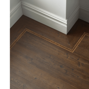

If you're going to glue plastic flooring to the WBP then other makes are available including Karndean and Polyflor. The latter do some interesting marquetry style edging.
I've used both products in my houses, Polyflor a bit cheaper than Karndean.

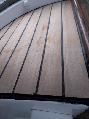

I glued 4x46mm dark hardwood stripwood separated by 4x4mm lime wood strips onto my very scruffy plywood cabin sole. Matt or satin floor varnish. Looks really good and, so far (4 years), has worn well. Plenty of wood that, if in the future I need to sand it, no risk of going through a veneer. Has the added advantage of being easy to apply to a non-flat cabin sole.
Richard Burbidge STW1001 - 10 DHWD STRIPWOOD 4 46 2400 [PK 10] - previously FB178 - Stripwood - 2400mm Dark Hardwood - Mouldings
Lime Strip 4 x 4 x 1000mm

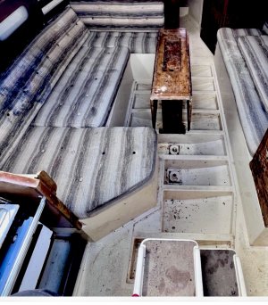

Just to say I appreciate all the helpful ideas and aren’t ignoring the thread! I’ve only viewed her once but she’s being delivered to her new home by road on Tuesday when I’ll start work on her and make a decision on which idea for the cabin sole to adopt. At present she doesn’t have a sole at all, I’m going to make a cardboard template for starters. And before comments on the picture, Yes, she’s a doer upper!
