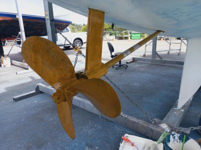

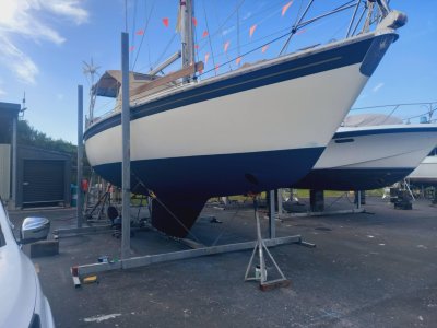

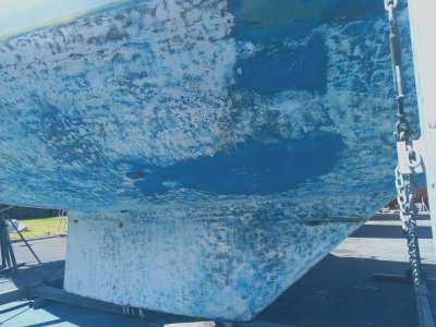

So my issue is, she has a few blisters size... 10-15mm.(and smaller) Wide spread mainly aft, as you can see she is kitted out for offshore cruising, but the question is, do i buy or not, please give me your honest opinions, if i buy obviously a full survey will take place, i have added some pictures, WhatsApp Image 2026-04-07 at 14.11.03.jpegWhatsApp Image 1.jpeg

Presumably that is not in the UK. If it is in the EU then it may be EU VAT paid status depending on where it was on 31/12/2020. If it is outside either territories then the "all taxes paid" is meaningless. Probably one of the reasons it is not much more than half the price of a similar boat in similar condition in the UK is because it cannot be brought into either territory without importing it and paying VAT. Whether you buy it depends on your plans. If you intend ocean cruising and not bringing it to Europe then it may be a good buy. Registration is irrelevant. If you have more on the provenance - its past history of changes in ownership and where it has been you might be able to work out where you can use it.
Osmosis blisters are common on these boats and not a reason for rejecting it. Plenty of material available as already suggested to help you understand how to deal with it and keep sailing.

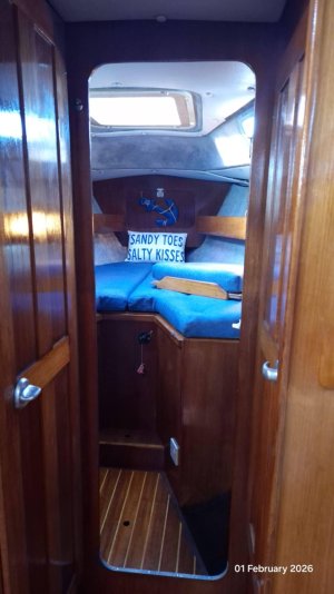

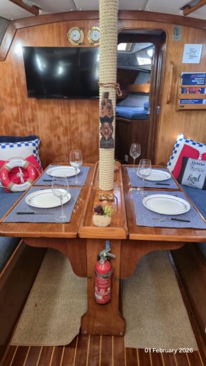

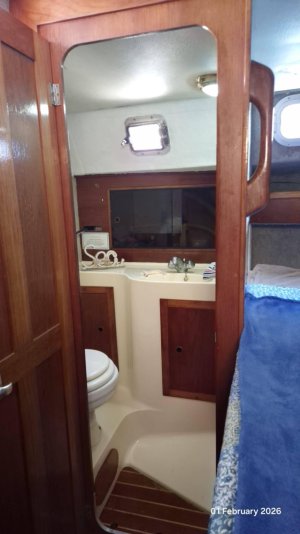

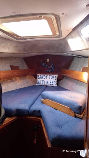

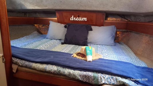

The price for the boat is very keen for one of these. The condition of the interior woodwork is showing signs of lots of wear. This is not expensive to solve. Westerly used a 2 pack lacquer, not varnish. On my Fulmar I stripped my woodwork back to bare wood and recoated with 3 coat of the original lacquer. I made a PowerPoint presentation on how I started this. I should mention I changed the stripping from a cabinet scrapper to 1½" chisel sharpened on a small diamond grinder and using the burr. The lacquer is quite soft and easy to remove. I did the whole boat in stages of stripping and immediately refinishing immediately. You would need 10 litres and this should cost about £140 including 5 litres of thinners.
https://wiki.westerly-owners.co.uk/images/2/25/Interior_Woodwork_Concerto_PowerPoint.pdf

The only thing that would concern me is what make is the in mast reefing system, is it an original or add on if the latter I would be dubious.
How do you know this?
Have you personally inspected or is that a report from a surveyor or the owner?
Have you popped the blisters yourself or seem photos of them popped?
How many is , "a few"?
remember that the seller it trying to actually sell the boat.
My opinion.
Blisters can mean osmosis ( a deterioration of the FRP that allows water to enter the matrix) or it can be a lifting of the gel coat or anti fouling, so identifying what the blisters are would be my first step.
Either way, it would not worry me that much. No boat as sunk from osmosis, however (I just checked AI with the search "osmosis in a westerly corsair") it is not uncommon for older Westerlies to have the hulls stripped and treated. You could get a quote on that if it bothers you that much.
As for boat and gear. The list of what is fitted is very impressive and would show that the previous owner was serious about the quality of what was fitted.
I say, Go, now!
Gary

Hi Gary,
Many thanks for your reply, i received a couple of pictures from the owner, he said its widespread mainly aft, i have a surveyor going to look at the Hull on Monday, so hopefully will have all my answers, the Owner has been really upfront and honest, and i believe the price and the ability to just walk away should the readings be through the roof, why not consider this a lot of boat for the price
There was an old saying....No boat ever sank of osmosis. I don't know how true that is but I see most plastic boats in the yard with blisters underneath. My own boat came with added blisters, I think if you burst them and they smell of vinegar it's not good. But don't let that put you off, just clean out, dry out and fill them.
