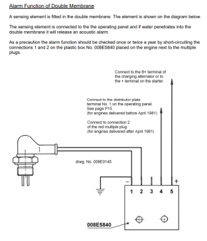

Can anyone help with this query please. My sail drive has the rubber double diaphragm water penetration sensor connected to a small red plastic box at the rear of the engine. It has two sets of identification numbers. One is referred to in the Bukh service manual, i.e. 008E5840 and on the other side it has T341ZCD. The manual suggests regularly shorting two of the terminals on the box to test the water penetration alarm. When I do this, my alarm does not function. My query is, can anyone tell me what is inside this wee box and how it is intended to work? And if it is likely to be faulty and resulting in my alarm not working? Thanks.

It would be worth shorting the lead on terminal 4 to earth to check the warning light and wiring

For what it's worth, I think that the red box contains a bit of electrickery that is putting a pulsed voltage across the sensor pins, and when it detects a current flow, it switches the line to the alarm on.
Looking at VicS' diagramme, shorting 1 and 2 should result in the alarm sounding and be a test of the red box and alarm.

Check if pin 1 is also connected to battery negative (possibly via engine ground) and pin 5 battery positive. If so, the box is broken. In the box most likely is a tiny little circuit with at transistor and a relay that amplifies the meagre current from the probe through some saltwater and switches pin 4.
New box costs very silly money, so find yourself some circuit diagram on the internet and build your own or buy a 12V water alarm with relay output.
Could be as VicS says or if not. Disconnect either 3 or 4 which ever you are using and try connecting it to + at 5 and see if that works. It maybe that the action of the sensor switches through the box to put + on terminal 3 or 4.
Edit: Alternatively use a meter and measure between 5 and 3/4 and also -ve and 3/4 with and with out the short between 1/2 and see what you get. I suggest disconnect 3/4 during this test.

Having studied a Bukh wiring schematic and an owners manual I now realise that the sail drive water intrusion sensor does not have a warning light and that it should only sound the audible alarm. Is that correct?
It operates by grounding the negative terminal of the alarm. The high temperature sensor and low oil pressure sensor ground the same terminal via diodes on the diode plate.
If the wring between the the red box and the engine control panel is OK shorting the wire on terminal 4 to ground ( engine block) should sound the audible alarm ( provided the panel is energised of course)
I dont think I would want the sail drive water sensor to sound the audible alarm. I think I would add a warning light and rewire it to just illuminate that.
Sounds good. I think that switching the negative is pretty common on these alarm systems. Shorting 4 to 1 should also work. I assume that he has terminal 1 grounded?
