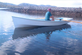

After many months contemplating free plans for a dinghy I saw a thread here asking if anyone had built Flint by Ross Lillistone.
Link:
Well. I was hooked and duly forked out for the plans. Next spend was for the glass tape and mat and epoxy for stitch and glue plus optional extra all over glass skin for "abrasion resistance". Next will be for the ply. meanwhile, since there are trees to be had here and a bloke with a Wood Mizer to plank them, I set to getting the timber for a multitude of fiddly bits and oars and mast and spars.
Dont hold your breath, this will take some time.....

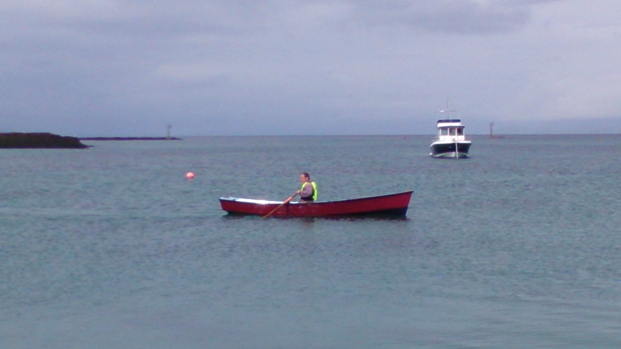

Why the wait, I hear you ask. Well, apart from someone deciding that I wanted to buy a boat instead of building one, doing the deal then telling me about it. A boat that kept me busy and skint....
Top tip: start with the little bits. I dint and it felt like hitting a brick wall when I got to all the braces, reinforcers and brackets.
After a year or so of sailing and fishing round Eigg, along came Barbara and Conor. The 2 storms double teamed me, broke the mooring and bounced my boat off some rocks. Nice way to spend Christmas day, waist deep in lovely warm (not) sea water.
