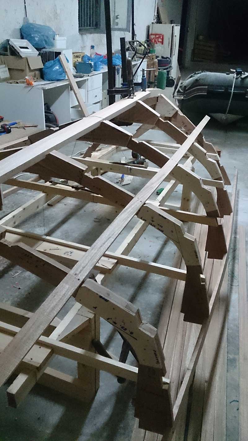

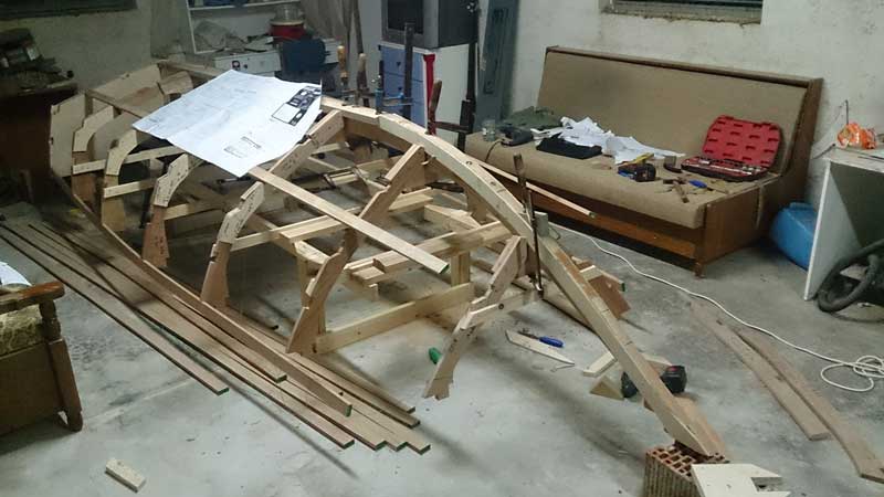

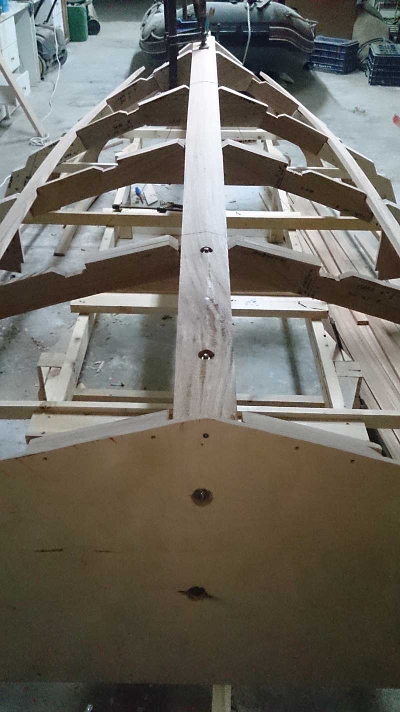

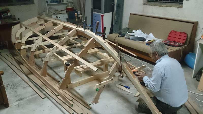

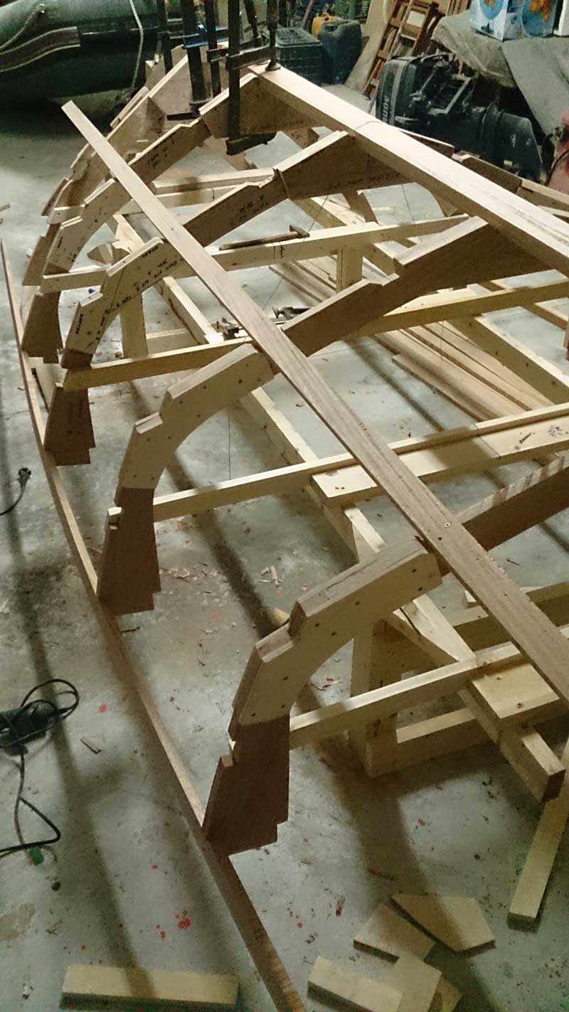

reporting for a good friend Dimitris, with a Broom36 on the hard for the last 6yrs (and possibly on sale) and a P45 in action.
Dimitris is an engineer, also a hands on person and due to lack of construction work atm down here, with lots of time to spare. So he decided to go ahead and built a brand new 4.5m planning hull open boat from some drawings bought (iirc 150euro or so) from a naval architect in Athens) Model is Τοξοτης (archer in English) and this guy has over a dozen different designs on his website: https://sites.google.com/site/greekboatplans/designs/speedboats
Dimitris wants to built the normal (non-cuddy) version.
Anyway, he also happens to be a v.good carpenter (professionally, not an amateur like myself) and with a fully equipped workshop. So got the plans, got the right timber, cut the frames, keel et al, and on Sat I spent a good 6h helping him put the frames and keep together. Some jobs are not really one man and anyway it was really exciting working and seeing the frame of the boat come up in front of your eyes. Looks like next week he'll be ready with all frames mounted and epoxied in place and I can go and give him a hand in adding the 8mm ply skin.
A few photos follow and a couple of Q after that
