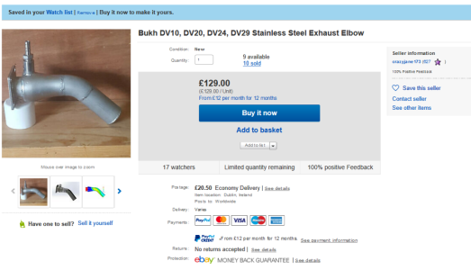

By the way, there is a firm in Ireland that makes s/s elbows at what seems to be a reasonable price.
That listing is no longer active but, if you are interested, it might be possible to track the seller down.
