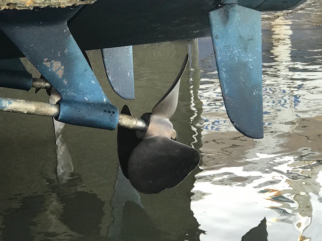

If thats the boat in question you have too much shaft protruding the P bracket , maximum allowable shaft between the end of the P bracket and Prop hub is 1.5 times the shaft diameter , any more and you will get whip in the shaft and vibration .
Something not right there , looks like someone has added R and D plastic couplings possibly or a spacer to allow rope cutters .
Thanks Paul.
Picture is of my P35.
Replacement for bent shaft machined up to the correct and (shorter) length.
The other shaft was also replaced by me due to pitting inside the stern gland and again was cut to correct length.
The boat was previously based in Wales for many years, the shafts/ P brackets were replaced after the skipper heavily grounded the boat .
The boat also had two replacement MS4B fitted early in its life.
There were indentations in shafts suggesting that rope cutters had been fitted at some point.
