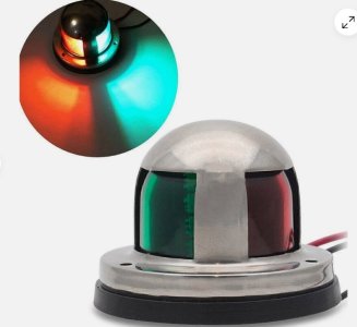

I have a small dome shaped duel LED light on my speedboat that even though small is very good and bright ...
But it would need to sit on top of pulpit or on a shelf under ..

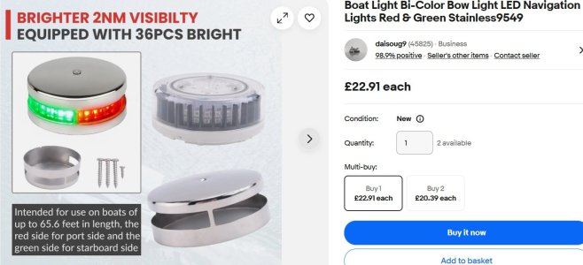

This may be interesting ... if it does come apart as shown ... then flip the LED internal round so case is other way up to fit under 'seat' ....
Edit : On studying the pictures - I don't think it can be flipped 180 ...
