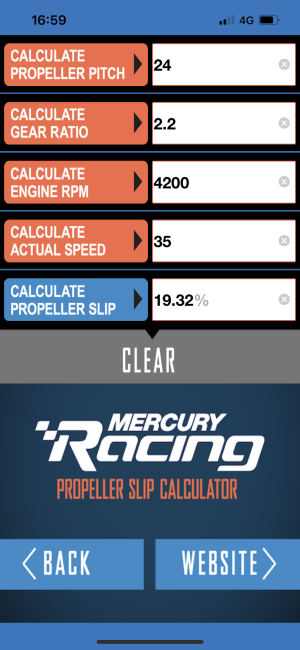

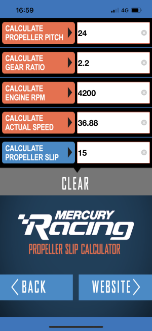

PC. Any pics of the boat and also any details of how they performed with their original power plant ? All I can see for a v204 is a more modern 90’s/00’s 20ft bowrider thing. I presume with this one of yours being 3000kgs and 24ft…it’s a much bigger thing. Is she wooden or grp ? Be good to know ball park figures of how they perform with similar Petrol power or what ever they once had in them.
If she’s expected to be around a mid 30’s or perhaps a few mph more..we are likely talking about a set of 24” props as a ball park. Couple of realistic figures using an assumed speed in the mid 30’s and if able to achieve the 4200 rpm. 15% slip is a decent figure to be aiming for, perhaps she’ll be a little higher from a first effort, given the unknowns at the minute. These props aren’t cheap at all and could end up an expensive guessing game. But if you get a set of 24’s for a good price. That is a fairly common pitch and always sought after used. Won’t be an issue selling them on again, if at the right price to start with. These props are all stainless, as you’ll know. The additional complexity when propping a diesel, a turbo diesel in particular, is the need to not only get the right pitch for top end rpm suitability…but ensuring that there is suitable pitch there to load up and spool the turbo, down low in the rpm too…as you’ll know. Anyway. Around the 24” mark might be a good starter for 10..won’t be too far out, either way I’d think. Unless she has a pace expected that’s way off my assumptions. See what you think

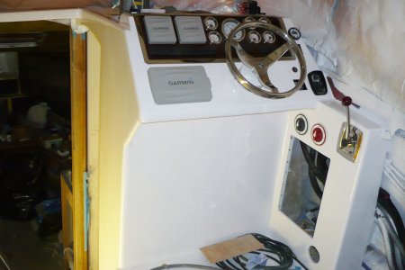

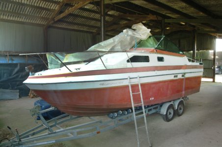

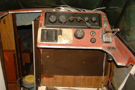

Thanks Q, here's a pic' of the boat when we had just collected it. Everything has been removed and scrapped including windows, rails and rubbing band. Hull is a shallow vee.
I haven't got any decent exterior pics of her current state but here are a before and after on the helm and instrument panel.
No performance figures as I never saw it leave the marina and when I got it, it was laying on the ground in the yard.

She looks beautiful. Stunning.
