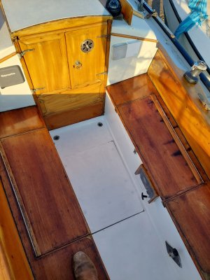

Am I allowed to use brass wood screws for the hinges on my companion way flap? Section just beneath the doors...
