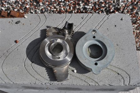

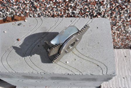

Don't forget you will need a new fixed cutter for your Stripper (if you still have the original) because the cap screw for the locating peg is in a different position. Everything else is the same except of course for the 2 piece anode which still needs drilling for the peg - just a bit more challenging as it is drilled across the join between the two. Worth getting a new modified anode so you can see where the hole is drilled and the excess milled out inside.
Daydream believer
6 Oct 2012
19,237
Southminster, essex
So I will have to make another then. I have some spares. I also buy standard anodes & machine as required.
But when i get round to finish building my forge I will cast my own.

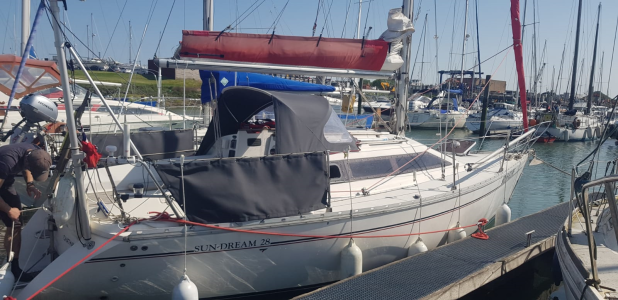

Had a fantastic weekend to Bradwell Marina, Lovely area. Sorry I never got around to visiting you on your berth Daydream, was so busy getting things sorted. I found getting onto the berth tricky due to the gusty winds. Not much grip on my twin blade prop going in reverse, as i tried to do the manourvre the wind then pushed the other end of the boat out. Great Marina though, lovely location. Didnt have to cook once on the boat. But i found the food at the Green Man pub horrid and overpriced. The cafe box with the two woman was welcome and a great place for breakfast in the morning meaning no washing up to do on the boat. We pretty much motored the whole 50 miles there and back, and my 2GM20 did fine, phew! But I did get water inside the sugar scop via the rudder somewhere :( The jouney was quiy rough going to bradwell with no sailing until we go the the river Blackwater. Lots of wave slamming due to wind over tide.
friend on his boat
