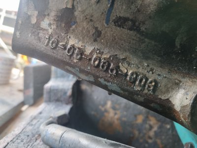

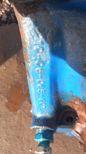

The casting number on the "new" one is 10-05-065-903 as best as I can make out.
The number on my original is 10-05-065-901 as best as I can make out.
Do any of you know what the difference is?

Third, I suspect the numbers you have identified are model numbers for the different gearboxes. That raises the question as to whether the only difference between them is the output shaft and tail end casting. If so, it would be pretty easy to swap the relevant parts from one to the other, subject of course to cleaning up the old casting should it have suffered from the water ingress, and replacing bearings and gears within the assembly as necessary.
