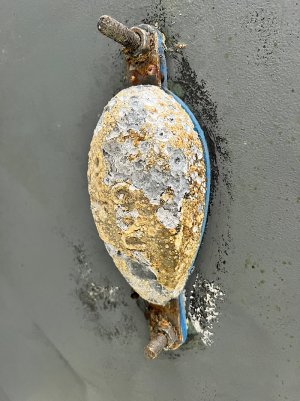

This is our first season with a boat that has hull, engine and prop anodes. I posted back in August how I was surprised to find the prop anode had completely wasted after four months. I fitted a new one at the beginning of September.

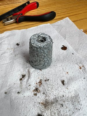

So, the boat had new hull and prop anode fitted this season and the pencil anode in the VP 2003 was good enough that you could still make out the lettering cast into it, tho I don’t know how old it actually was. The previous owner also had a new prop fitted whilst shore last night winter, presumably the previous one had de-zinc’d but we never saw it.

I removed the engine anode plug to flush the engine when she came ashore the other week only to find no anode left, well, barely a trace.
The replacement prop anode was already beginning to noticeably degrade after being fitted for four weeks (see photo).

If the hull anode is 8ft from the prop it is probably too far away to be very effective.
If it is only bonded to a keel bolt it will be offering no protection whatsoever to the prop.
Prop anodes do erode fairly quickly due to being fairly small and in contact with a copper alloy item with a relatively large surface area ... viz the prop.
A hull anode much closer to the prop and with electrical bonding to the prop via the engine and gearbox might help a little but in any case will serve as back up if the prop anode is totally consumed or lost.
A shaft anode would be better if one can be fitted. I see that it isn't.
The engine anode is a separate issue. It protects only the engine cooling system. Replace it.
