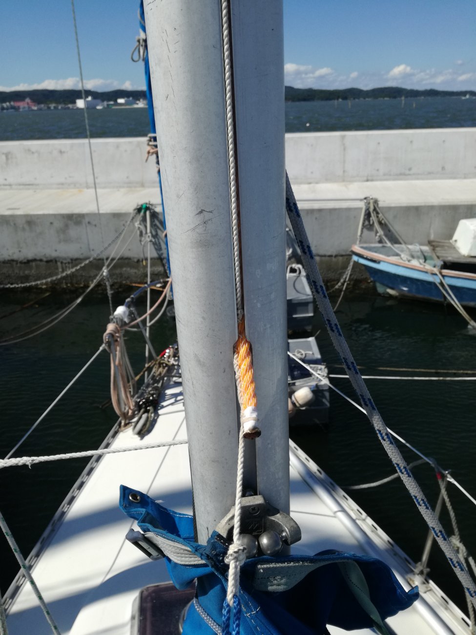

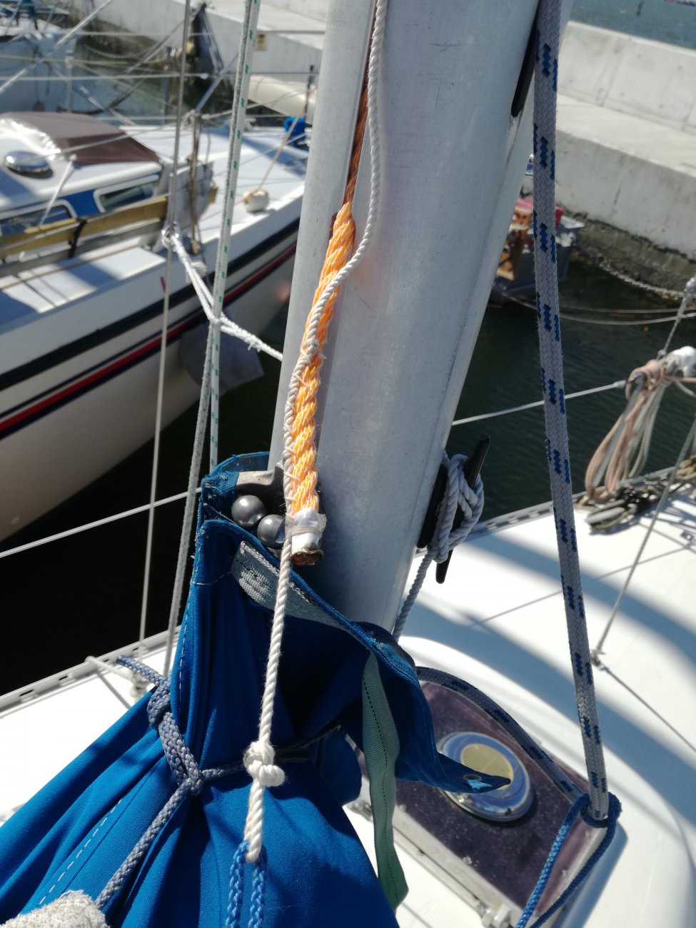

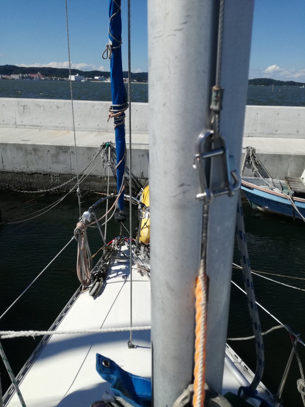

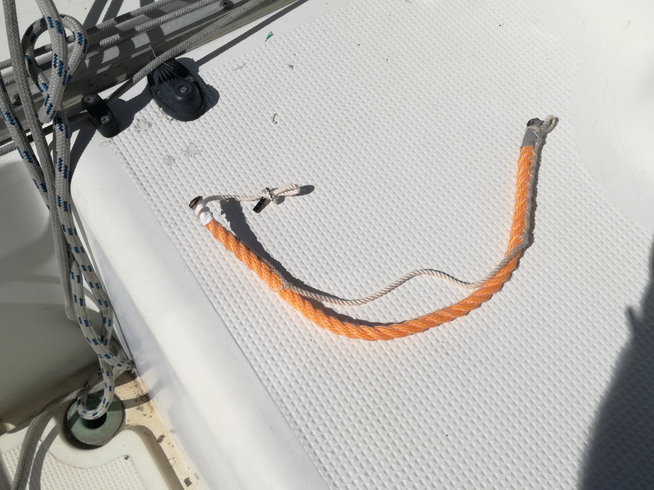

To both clean and check the condition of an internal track I highly recommend making a simple track cleaner.
You need about a foot of rough cleaning rope that fits the track pretty snuggly.
Parallel to the rope you whip on a piece of lighter line that is 2 or 3 inches longer at each end (See Pic 1).
There should be an eye in each end of the lighter line.
The whipping will make the diameter of the rough cleaning rope even snugger in the track.
Connect the main halyard to one eye and feed cleaning rope into track. (See Pic 2)
Connect a light down haul line to the bottom eye.(See Pic 3)
Haul up a yard or so and haul down a few times then repeat as you raise the line up the track.
Pay attention to the spot where you think the sail is binding.
When you have cleaned the whole track haul the cleaning rope down , spray it with track lubricant (silicone spray) and repeat the haul up/down to lube the complete track. Will take 30 minutes to make the cleaner and 30 minutes to clean and lube the track. I do it once a year as a part of maintenance.
This will solve the it's a pain in the after to raise, lower problem.

Slugs will not solve this problem.
Do you have lazy jacks?
If not fit some.
If so, make sure that they are rigged properly.
