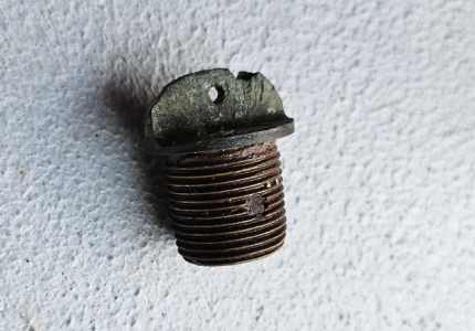

My (new to me) 77 year old wooden boat has this bronze plug below the waterline. It's fairly important that it doesn't come undone! It looks like it once would have had a wire mousing to the plate it goes into but now there isn't anywhere to wire it to. Any ideas what would be the best approach, cross fingers? PTFE tape? boss white and hemp? Is it even possible that the engine vibrations could loosen it?

This sort of plug used to be, and maybe still is, standard on speed boat transoms. I never had one come loose so you should be quite safe with it. I believe the cord is to put a loop through it to hang it up when not in use.
By all means carry a spare. I can assure you that many a speed boat has been launched with the skipper forgetting to put the bung in. The boat takes a while to sink so you have time to realise the error of you ways or recover if yours inexplicably fell out.

The hole in the plug is not for mousing but is for a piece of cord or light chain to attach it to the boat to prevent its getting mislaid.
There's no reason it should work loose if you tighten it securely but a fibre washer under the head would be a good idea

Does it work (ie seal?). modern plastic ones are not normally moused to stop coming loose spontaneously - but a lanyard on it so you don’t drop in the sea/leave it on the slipway etc is a good idea. You just need a length of line fastened to a small eye/ring.

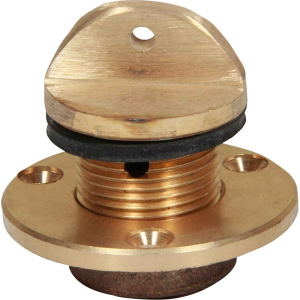

If it is a tapered thread then PTFE tape or Boss white and hemp are the way forward as the seal, must be made on the thread.
If , however, the thread is parallel then the seal should be made with a joint washer under the head :
Replacements available from ASAP supplies

The OP's one is identical to the one in the keel of my launch to drain the bilge when it is ashore. It has a leather washer. I have a piece of rectangular steel bar with 2 slots one end & a hole for a 150*8mm bolt the other as a handle. I use this to get it nice & tight as it is awkward to get a spanner on to it when the launch is on the trailer. Using this gadget, I can grip it firmly. I usually add a few turns of PTFE tape for good luck. It is a parallel thread, so that it tightens on to the washer. The leather washer swells slightly when immersed in water which adds to the tightness. The hole in the lug is for a cord to hang it up when not in use. Obviously I remove the cord when it is in place, as it is permanently below water. It is only 3 feet from the engine & has never come loose.
When I first bought the boat, I turned up an Oilon plug as a spare. I felt that Oilon would swell a little & increase water tight integrity. So far I have not had to use it so do not know if it would jam in place
What I did find, was that the plate that the plug screwed in to was not properly fitted & leaked. The solution was to remove it & replace the original screws, with bolts. I rebedded the unit in Sticks Like & tightened it up with penny washers on the inside of the hull.
I would imagine that the OP may have to inspect this part as well,l if the fitting has been in place for some time.

I don't know yet whether it seals, and no sign of a washer.
