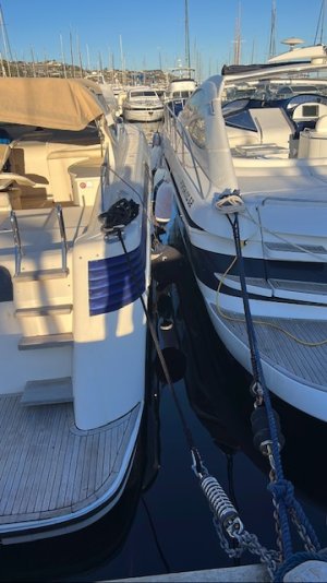

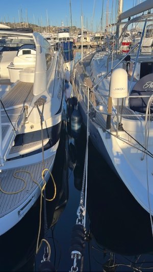

The berth is wide and the area wind sheltered + it easy to turn etc etc .

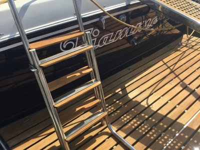

Well I am utterly and totally delighted 😀.
They copied the name font even the SSR No , and kindly moved the two lower “ lines of beauty “ ( that’s what they call the white lines btw ) a bit higher away from the WL .
Here s a few pics .

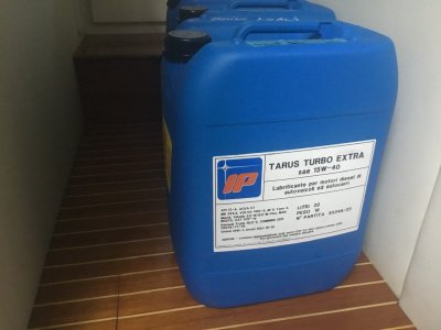

Typo should have been 15/40 it’s home brew Italian , IP “ Italian petroleum” 👍.3275
Only did 50 hrs last season .One does wonder , but something deep down tells me to continue doing annuals .It’s more of the additive package deteriorating with time than the actual lub element weakening .So it’s a time thing , despite so little hours compared to a truck , bus etc .

Regardless, the 15W-40 IP oil in the last pic that Porto posted is M3275 compliant according to its label, and that is what really matters. (y)
In fact, M3275 is the MAN coding for non-CR engines oils, as opposed to M3277 for CR engines oils.
