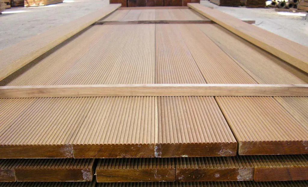

If the OP wishes to use wood I would use balau decking wood
http://www.hardwood-timberfloors.com/product_show-balau--decking/375/699.html
