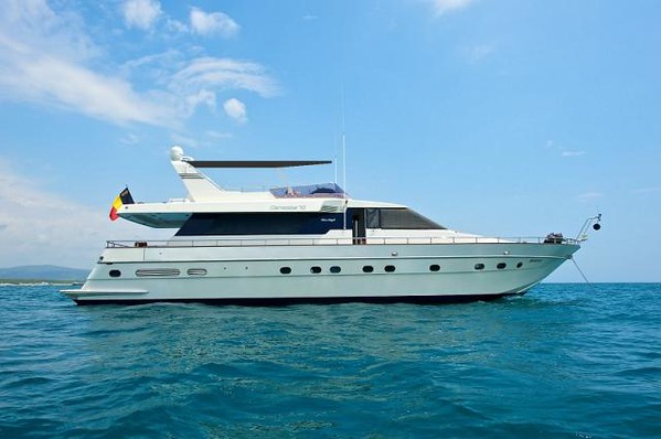

Another idea for a major upgrade;
While looking at different models from Monte Carlo Yachts, I got this idea for a similar hard top on BA:
I quite like this,
The first 1m of the hardtop would be solid, and from there would come a gliding roof system, so that the sun bed area could be opened.
This is a sketch of how this could look like from the side.
Does this look alright / nice, or am I blinded by my own pride ?
Do you like the dark metal grey look, or would you prefer simply white ?
Imo the dark metal grey hardtop combines well with the dark part from the superstructure around the windows, (now dark blue, but would like to repaint with dark metal grey in future)
I’m waiting for a quote for the gliding system from Opac Mare as used oa on MCY and Azimuth. So that’s under control.

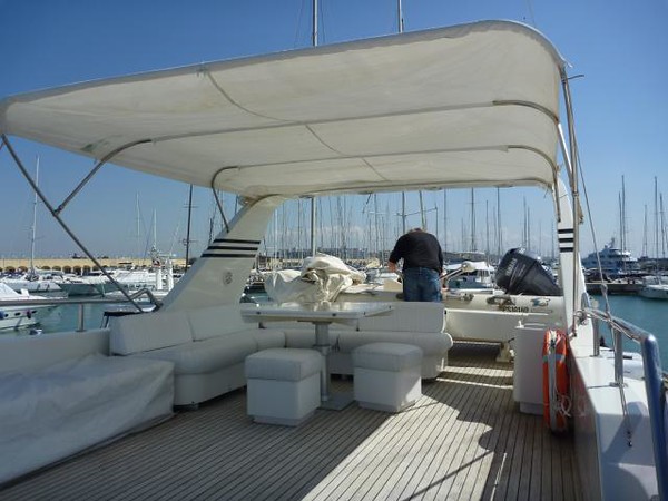

Or would you stick with a extension on the existing canopy ?
Problem is this reaches not over the FB helm position, and that’s the only position where I would like to have the roof almost permanently.
A separate independent canopy above the helm postion does not look nice I think.
Some pics from our existing canopy:
Sugestions ?
