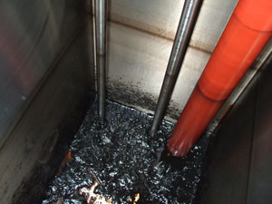

There might be sludge in the bottom of the tank blocking the fuel out/up pipe. That was the cause of my fuel system blockage:

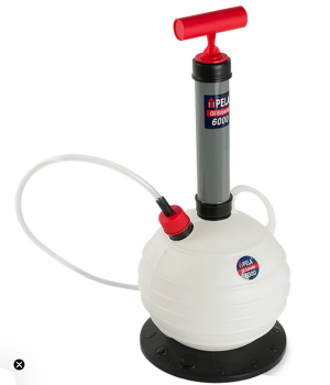

You can sample the bottom of the tank using one of these:
