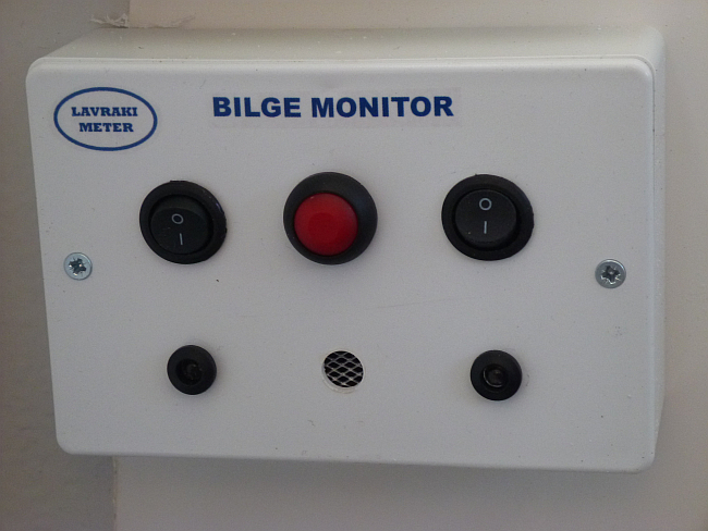

I made a bilge monitor with an indicator that flashes a light if the bilge pump has come on while I was away. It also runs a buzzer so I know if the auto pump has activated without me seeing it. Details here: How-to Guide: Make a Bilge Monitor - Boat Angling
