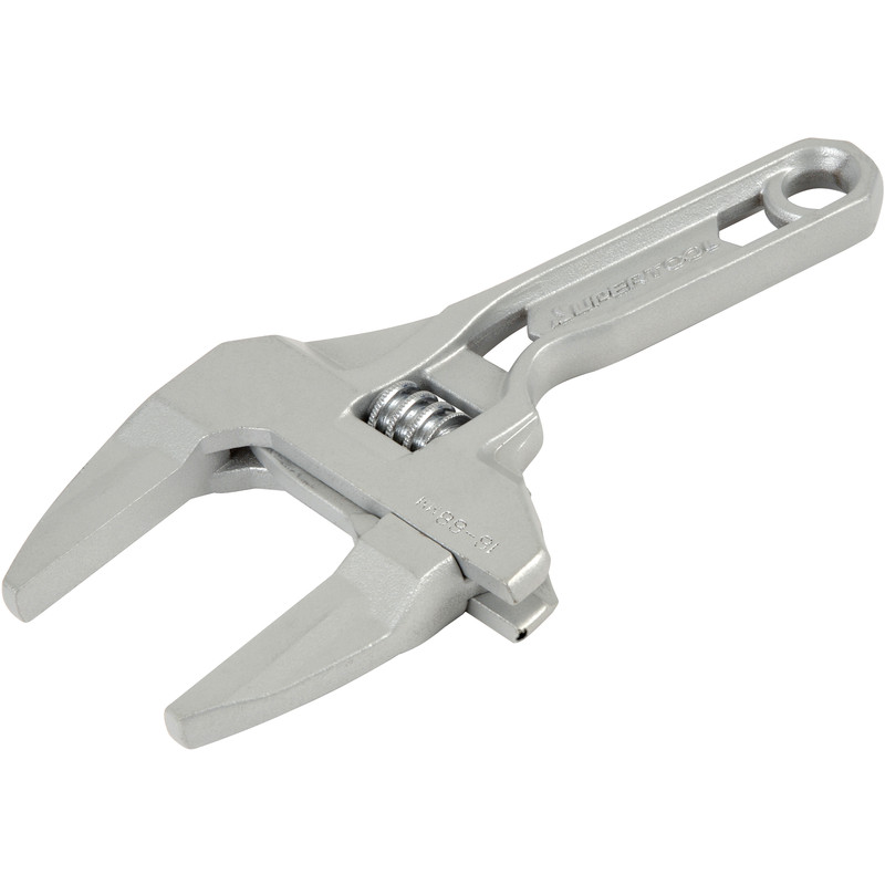

I'm just helping with a boat which has traditional stuffing boxes on the prop and rudder shaft. We just bought a huge adjustable spanner to fit the prop shaft only to find we need an even huger one for the rudder shaft. In fact two would be ideal to break the locknut. We used a pipe wrench just now but it's a horrible tool to use on bronze. Anyone got any recommendations other than cutting one out of mild steel with a hacksaw.

How about one of these?
