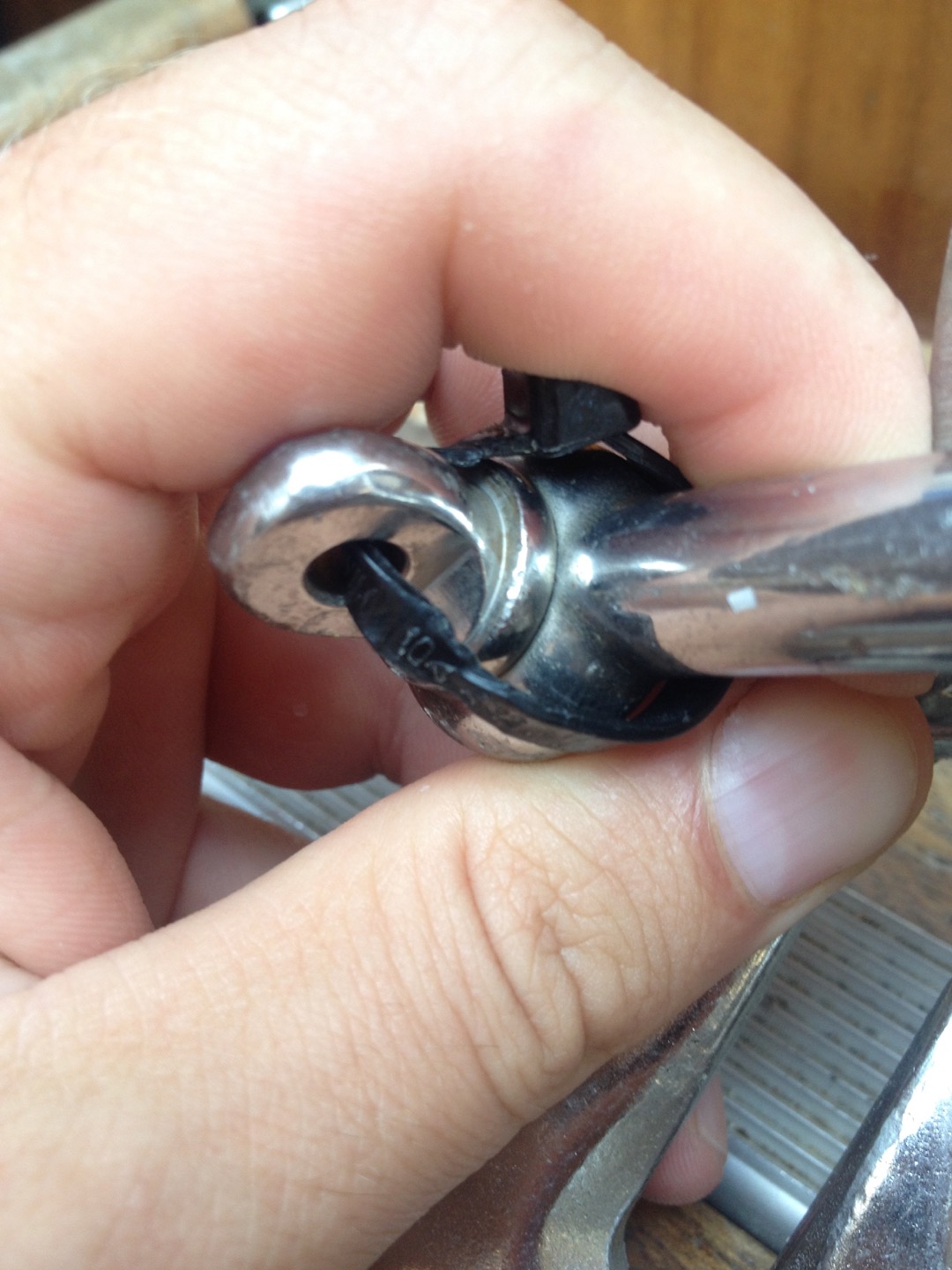

If you use black cable ties they will not degrade in UV light - well not for many years.
More like 6 months in the Med, then you start finding them on deck. And they're too weak even when new - we've had one on the shackle for the anchor snubber and that pin did work lose and chewed through half of the cable tie before I noticed:
So we're back to Monel. Still on the first little reel, so not too expensive.
That wouldn't have come loose if you had used a dollop of loctite.
