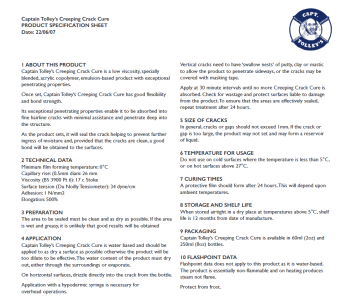

I had a old Vectra with a leak into the boot. The leak was occuring where the rubber seal didn't bed down properly over a weld.
I cured it with Captain Tolley's Creeping Crack Cure.
I have also used it very successfully on my boat.
But you must follow the instructions carefully.

Well, thanks for the suggestions. I have used creeping crack cure on the boat, and it sort of worked, but has limited gap filling abilities. There's two deep channels either side that the water sits in, so l wanted it to be flush.
