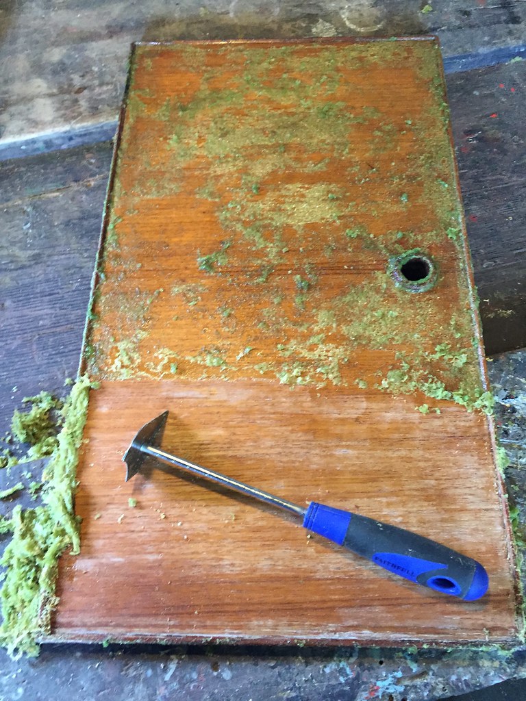

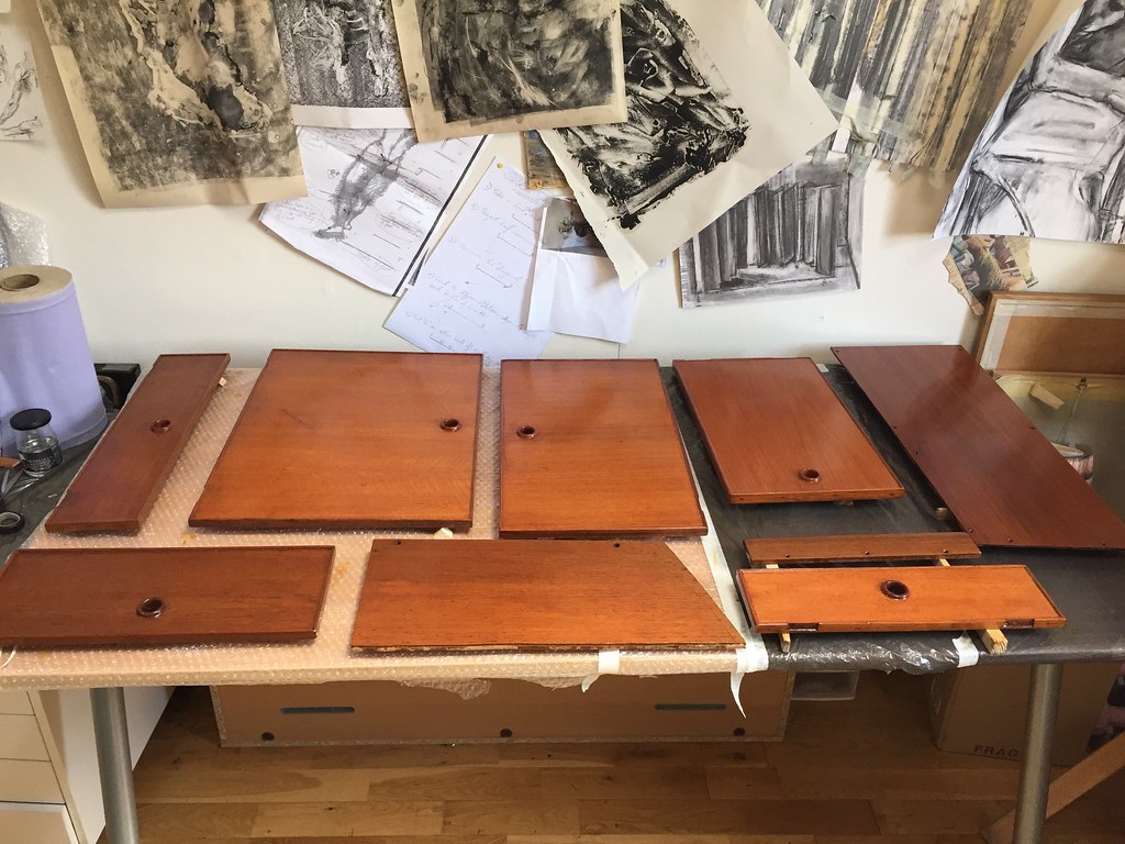

I used Nitromors to remove years of varnish off my cupboard doors. It gets a bad press on here, an average of 3 stars on some site ratings, but it worked well for me. It took an 8 hour day to prepare all the doors below. Each door took 2 coats of Nitromors and scraping with the grain. I stippled it on quite liberally and after 10 to 15 minutes tried with the scraper; repeat and scrape again. While I was scraping one door another was going through the soaking stage. After scraping I washed in running water, dried, sanded with a fine sandpaper, washed, dried and wiped with a tack cloth. The trick is to apply liberally and be patient. In the mid 1990s I removed paint from a banister with the a previous formulation and it certainly was a lot more aggressive than the new formulation. I will be removing varnish from a bulkhead on a 41' yacht, again years of varnish in layers and will use Nitromors again in about 0.5 square meter sections, as I am happy with the performance. The doors below took just under 2 litres. I bought the 2 litre tin and have small amount left, decant into a small jar with air tight lid and work from that.
Edit - just looked up the cost of Paramose and it is £27 for 5 litres, while Nitromors is about £20 for two litres. I guess I will be switching to Paramose for the bulkhead.
