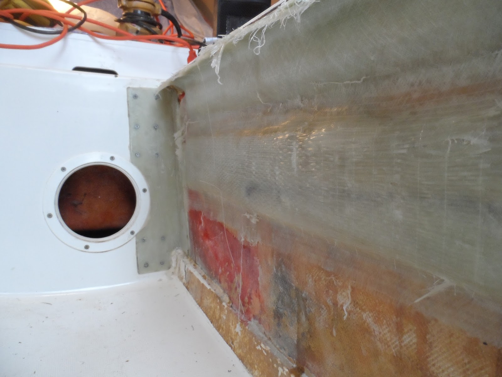

I had to peal back carpet to reinforce a centerboard case. Interesting project.
https://2.bp.blogspot.com/-G26Y_w-AgXs/Wguw4EeylMI/AAAAAAAAONE/RR4WUvTVfZYkjZj0XSG8AaNZnNXIxNv3wCLcBGAs/s1600/CB%2Bangle%2Band%2Bribs%2Bbefore%2Btrimming.jpg
http://sail-delmarva.blogspot.com/2017/11/a-work-day.html
