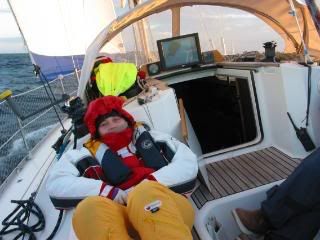

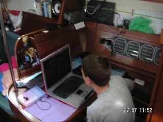

We use splash proof screen bought on ebay. Runs straight from 12v plug on deck. Extended VAG and USB cables from chart table. Generaly run only the screen on deck but will run from laptop below too. For the laptop we generally use an old Dell latitude 266 with PCplotter software as shown in the below deck photo. So far has survived two seasons including sail from Cumbria to La Baule in South Brittany and back last year. Has survived several gales including 44 knots of wind in the channel last summer on the way home. Would not be with out it now.
Costs
Screen £35, Dell comp £10, was being thrown out as battery was US. cables from old computers free. Software PC plotter plus navionics charts
http://i266.photobucket.com/albums/ii272/crewcharlotte/IMG_1943.jpg
http://i266.photobucket.com/albums/ii272/crewcharlotte/IMG_2087.jpg
Below decks with old dell computer with no screen and laptop on chart table
http://i266.photobucket.com/albums/ii272/crewcharlotte/PICT0020_2.jpg
