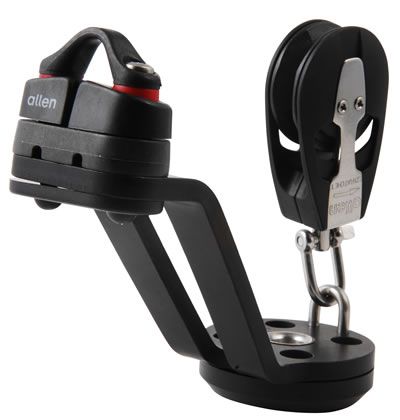

Thanks for this; I think you mentioned it in the summer and I'd forgotten. The swivel-base looks to me pretty flush with the top of the centreboard case, so can't be lowered - but it should be possible to stack the block above it on top of a disk of ply, so the jammer won't be usable unless I hold the sheet low over the sidedeck. Reminder made to self.
No, you've misunderstood me. The swivel base can stay where it is, no need to move that. Get the release angle right simply by changing the angle of the wedges/pads that sit between the actual cleat itself and the arm of the swivel base. Undo the bolts that form the vertical "axle" of each pawl of the cleat. Get the size and angle of these components sorted (the big wedge above the grey mounting, and the corresponding small one under it)
However, if you can't get the release angle right (it should release roughly at the point that the sheet leaves the side deck) because the sheet comes out the bottom of the ratchet block at too much of an angle, fit a longer shackle between the block and the swivel base. It's a really easy fix, spanners only, no need for ply discs etc.
Short shackle...
500cc1de0053dcd4170030e7
Longer shackle...
Geddit?
Pretty sure I do get it, thanks for clarifying. Of course, I can't find a photo of the cam cleat swivel today...but I reckon it'll be a longer-shackle job rather than a matter of angling the jammer, because the present set-up is high above a straight line between the block and the side-deck, and as you say, it's a pain to release under tension in a hurry.
I was imagining a disk of ply to keep the block stiffly upright - but I'll just use a taller spring.
