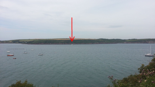

Our Bruce held rock solid at Dale during a VERY nasty spot of bother which blew up while we were walking around the peninsula. On the way back I thought I might find our boat had blown back onto the beach or the rocks but it never moved an inch. We got soaked on our return in the RIB.
