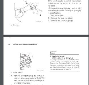

I realise that there might be dozen's of versions of the Tohatsu, but ot access the spark plug on mine there's a small 'snap-on' access cover. No screwdriver required.1716745249071.png

Access to the plug is much quicker - has a flap on mine - but yeah. Taking the cover off is a massive pain.
