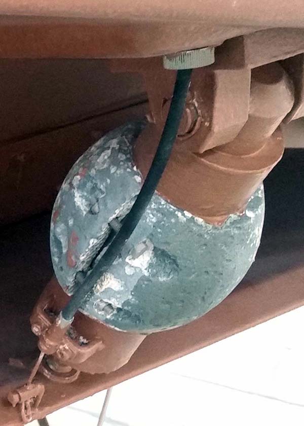

Fwiw, in the BCS system that I've got on the DP, the mechanical cable are routed only inside the stern lazarette, where they are connected to a black box (that I never had to open so far - touch wood!), from which an electrical signal is sent to two double gauges, one in each helm.
The other pic below shows the one in the p/house, just to give you an idea of how they look like.

Just in case looking at an actual cable might be meaningful for you, I'm attaching below the best detail which I found in my pics archive.
Don't look at the unusual reversed position of the cylinder - that is due to a rather peculiar stern shape, which surely doesn't apply to your boat.
Btw, the cable entry is waterproof in this installation, because it's just below the (static) w/line.

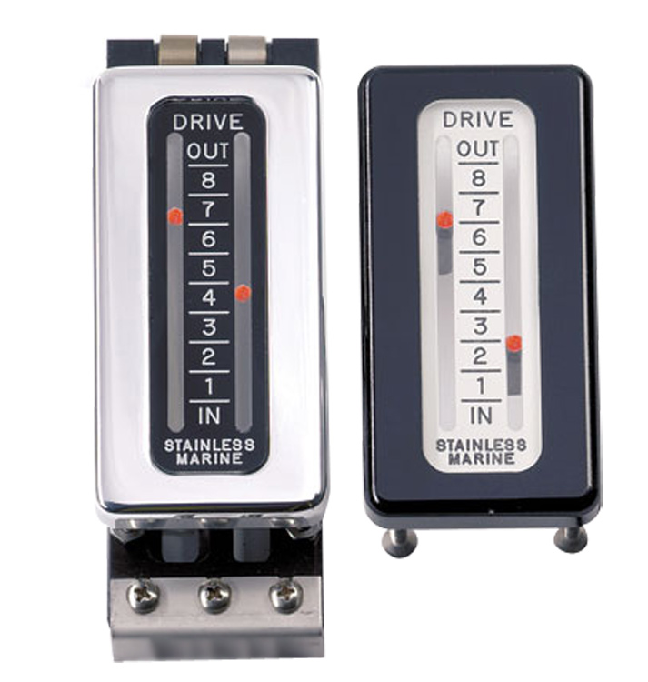

I googled around a bit because the indicators posted by BK made me curious, not having ever seen them mated to any Bennett tabs.
And they are built (as the pic suggests!) by Stainless Marine, a US producer of custom accessories for high performance boats.
Mostly suggested for K-planes trim tabs - the ones built by Mercury Racing. BK, were they retrofitted in your boat, maybe?
Anyway, they are designed to be installed with Morse 33C cables, if that helps.

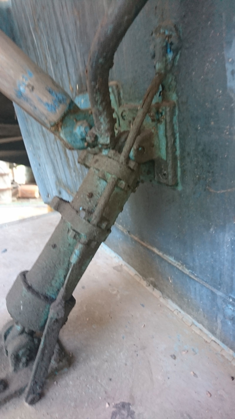

I am not sure Mapism. They, the indicators, are OEM to the boat and the boat is old at 1992. The tabs look identical to other examples of my boat so I presume they are OEM too. I dont have in my stock any clear photos but these 2 I do. On them unit there is no maker's mark
on the left by the CP

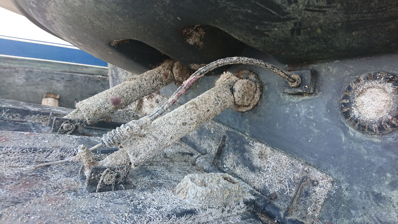

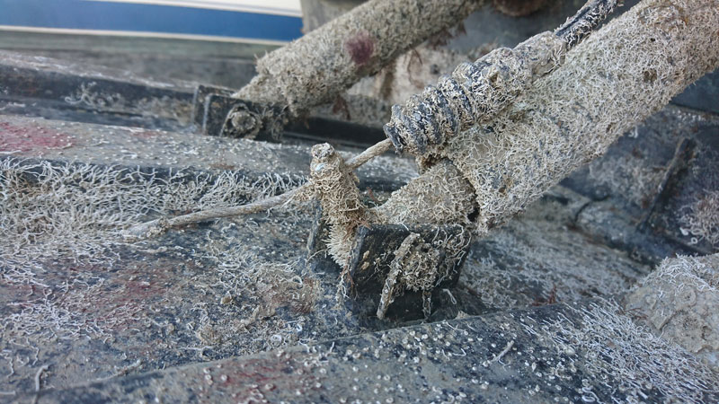

had a search around the boatyard and spotted 2 boats with external trim tab indicators, so on top of MapisM setup (P, I see your rams are steel, right?) I have another two examples of a similar setup on plastic rams
Broom 36 (or something like that). FWIW, the rams on the broom are same brand and type as mine (TrimMaster):
Azi 55 f/b:
Now, the broom has solid ss core and some flexthing on top two clamps to hold the lot on the ram.
The azi otoh is a simple multicore like an old school pushbike brake cable only thicker.

I think it’s the same hydraulic set up as MapisM
The cylinder actually looks very different. Am I right in understanding from your pics that yours have external hoses?
In mine, both the hydraulic flows (up/down) are completely inside the connecting block, and there are no exposed hoses anywhere.
