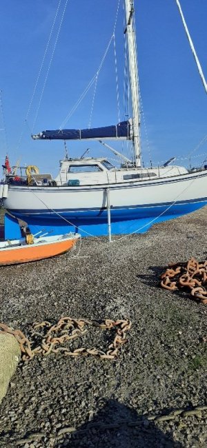

Firstly, legs work just fine on the type of boat you are envisioning. We have and use legs on our (pimped) Colvic Watson, see avatar.
I made them myself using tubular aluminium pipe and a simple bayonet style fitting that allows the legs to be mounted in seconds (don't ask me why that is a good feature). They can be divided in the middle and easily stored in the aft locker when not in use.

I had legs on two boats over 40 years, the first I made myself and the later ones were the sectional, from the Yacht Leg Co. The sectional legs could easily be stowed on board a smaller 32 footer, totally out of sight in the lockers.
"- staying overnight in a drying harbour.." I seldom did this, not worth the bother for short stays. I can imagine situations where it would be very handy, for example where you are staying in one spot for a week or in situations where there is little or no deep water available, places like Sauzon where you could be very snug inside or otherwise hugger mugger outside the harbour.
"- if tied up alongside drying on a quay/harbour wall do you also put out the leg on the other side 'just in case'" As others have said, not worth bothering, especially with a longer keel design of modest draught.
"- drying out on a flat beach you've scouted beforehand for maintenance / having some time on the beach etc" Good, as long as there is no cross tidal flow or heavy wash around.
"- any other scenarios where they are useful ?" It means most yards will accept that you don't need a cradle, excellent for your proposed longer trips where you may need unexpected maintenance stops or even overwintering away from your base. No bother with cradle pads or the expense of hiring a cradle.
In extremis it gives you an alternative in poor weather, in Scilly you can imagine a situation where it would be very nice to be able to take the ground high up on the beach at Green Bay Bryher, one of the most sheltered spots in the islands.

One (and a few others) of the photos on the Yacht Legs site is mine. Taken in the harbour at Ile d'Yeu, dried out with the dinghy alongside. The alternative was a buoy in deep water outside, in a Catherine wheel with 10 other boats. No contest.
