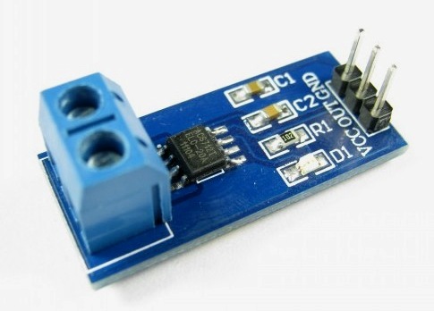

Which is where one of these comes in..Quite so, of course you need to measure the current, that's the whole point!
Hall effect current sensor. ACS712, 3 quid odd off ebay
