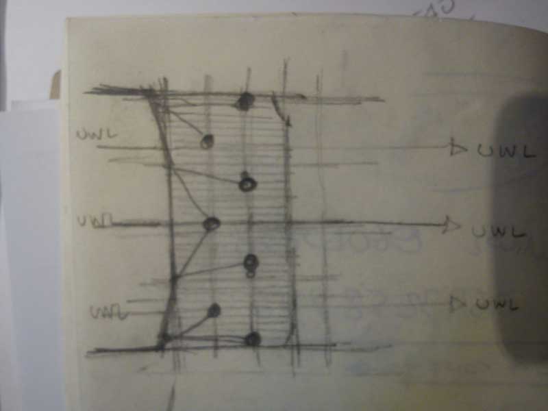

Plan is to have a 1.4m-1.5m long platform again for the full beam of MiToS.
Would like to support it from underneath on the two 1m long beams where the trim tabs are mounted.
V. strong and decent spot for the mounts.
Plan with frames looks like this sketch:

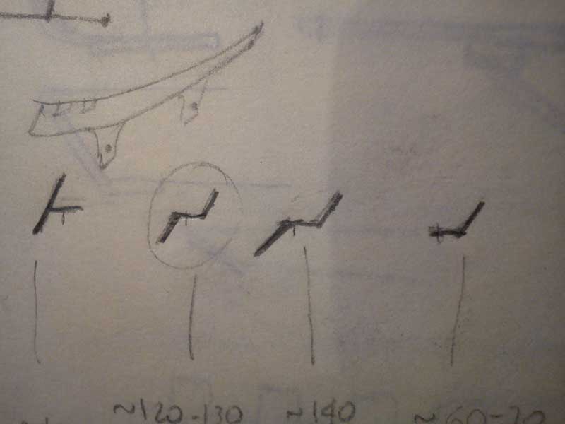

Was thinking that in section the 3 supports could look like that with the lower slanted ending aligned with the support points and the top part of each section "cutting" into the platform material.
Actually this setup would work if I had beams of solid teak (or mirande, or cedar or whatever) at 20x25mm running bow to stern. Then each beam would be supported laterally from the 10-14mm bits of ss coming up. The right hand side one on the sketch (rear end of the platform) V shaped would be capping the whole construction keeping the beams spacing right. Doh, reading it, it's not at all clear, need more sketches :(

I gotta dmit that I can't follow your post. I don't understand either of the two drawings, and I dont get what you mean by "the 3 supports " and "10-14mm bits of ss coming up". Perhaps edit a bit for readers who have zero in their heads about the job spec?! I do understnad "UWL" of course :D
I would think 10mm gaps are fine ref ergonomics, but you can set up a test using scrap wood. Gaps are hard work maintenance wise becuase you cannot scrub the edges down the gap, so you end up with brown tops and silver edges when you clean the teak
I think you should abandon the custom SS profiles in 2nd sketch, if that's what they are. Huge expense, and surely pointless. Use stock profiles only imho

Hi Vas,
I kinda follow the thinking, but had to re-read at least 3 times!
I gather you are looking at 4 lateral beams with the first attached to the transom, three struts/supports reaching to the second and four reaching out to the third? The forth beam is unsupported vertically as in an overhang, serving as a tie for the fore/aft slats?
If so, rather than creating 7 fixing 'points' (read pressure points) where I imagine there could be a tendency for the platform to warp, how about triangular supports running fore/aft that supports all three outer lateral beams - a bit like a shelf bracket? This would surely better distribute the weight?
e.g. a larger version of:
In terms of the platform, I'd make the gaps a bit smaller in view of the children's toes - unless going down the routed option and they're not deep enough for injury! I'm looking to do similar on a much smaller scale and plan to rout rather than slatted - just drain holes one end in the routed channels... :)

Vas, you will be more aware than most on here that struts at an angle work best in tension. I guess you have also checked out similar aged boats for their retro installation? What does Alf's boat have? I have seen boats with an SS frame, filled in with varnished planks. Looks great when varnished, and needs a bit of maintenance, but nothing for a man of your abilities.
