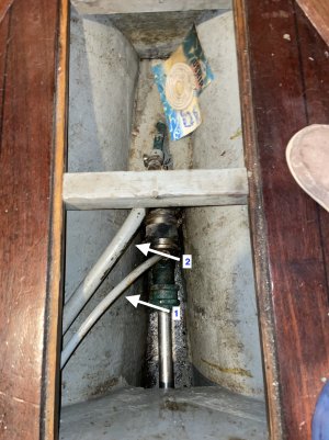

I attach a photo on which I have added arrows 1 and 2. Number 1 is the grease so I believe what is referred to in page 5 is pipe number 2.
Can you tell me more about this NOTE please? Can this sink the boat? What is the risk involved?
Our boat Barbary Girl is all the time in the water (so she is afloat), my father in law never told me about this procedure. Unfortunately I don’t have any photo to know where the other end of this tube is plugged.
I therefore also plan to replace this tube, as it is probably old, like the boat itself.

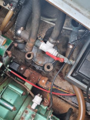

The white lever valve closes off water supply to the stern gland. The two black hoses, one disconnected, form the loop to the antisyphon valve mounted in the cockpit locker. I have the exhaust elbow removed...

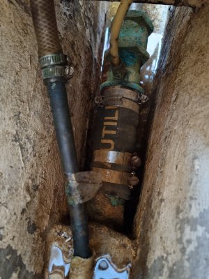

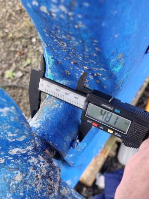

The external diameter of the stern tube which is under the rubber pipe (blue arrow) which should have logically the same value as if is measured from the outside (white arrow).
Many thanks
Looks the same as in post#29 with the stuffing box on a hose. If so then the diameter of the tube is likely to be 48mm so a Radice seal will fit straight on.I can't access the stern tube from inside, mine is slightly different to yours in that the stuffing gland is forward of the sterntube. In any case it's glassed in, so I couldn't measure the tube size directly.
Thank you very much for taking the time to make all these photos.I can't access the stern tube from inside, mine is slightly different to yours in that the stuffing gland is forward of the sterntube. In any case it's glassed in, so I couldn't measure the tube size directly.
If you look on p35 of the catalogue you will find the Radice in imperial 1 1/8" bore and 48mm stern tube. Important to get exactly the right size. A water feed is not essential as the feed tube from the seal can be used as a vent to ensure there is always water in the tube and it fills when you launch. However as you seem to have one already makes sense to connect it.Thank you very much for taking the time to make all these photos.
To be honest I was somehow hoping for a external diameter of 44.45mm (1 3/4") which seemed to often match a 28.6mm shaft (1 1/8") but you measured more (close to 1 7/8").
