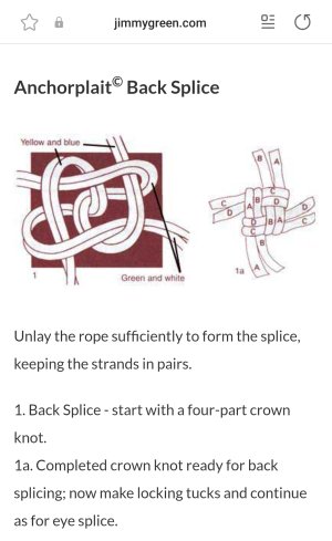

I’ve spliced loops in the end which is the same process, actually easier than 3 strand just find a good guide or video. Essentially you mark two sets of two which are on opposite sides of the rope and then feed these under the non marked ones while passing the non marked under the marked. Or buy pre-marked rope like Marlow or Jimmy Green. Do about 10 links worth and neaten off.
One thing I did learn was to not keep the pairs taped together as they twist horribly. Use them together but keep them separated.
Try not to look at the left side of that diagram, it’ll drive you crazy. The right one is helpful and once you have the rope unlaid will be relatively obvious how to achieve. Don’t forget to tape the point where you will splice from, this stuff comes apart easily.

Thanks all. Never thought the Jimmy Green would have the answer. It is my usual cordage supplier, but unfortunately needed a very fast turn round as I have a new mooring and the existing warps had been in the water for three years and rather mussel bound.
This new line is very pliable and already deployed. Not sure if I could get the purchase sat on the foredeck to do a really tight whipping and burying the melted ends in the rope does appeal.

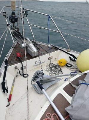

Yes, you can do it. I made an anchor bridle with two equal length spliced loops in the end (and a brummel splice in the middle). Although not perfect I was happy for a 1st attempt in octoplait. Followed online instructions, can't remember which but it's just like doing 3 strand plus some added complexity.Screenshot_20230828_155220.jpg
Don't ask why the NG anchor is on deck. The splices have withstood plenty of blows.
You might just as well put an eye splice in both ends.
Then it doesn't matter which end you pick up.
I think I'd struggle undoing the massive shackle that is attached to the other end.
