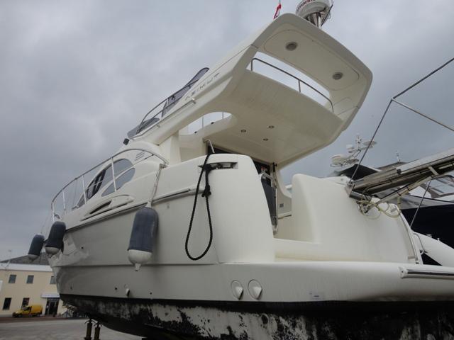

The picture below is of an Azimut 39 with underwater exhaust ... but the small outlet just in front of the fender here is the exhaust outlet which is used at start-up and idle ... once underway and at higher RPM, there is a flap in the exhaust system which diverts the exhaust under water..
I believe the trend in underwater exhaust systems was to reduce noise and to make exhaust gases emerge further behind the boat when underway (to reduce soot on transom).
I do not believe that you will have less smoke at start-up with your 61 series engines just by installing an underwater exhaust system.

Hi all. Many thanks for advices and pictures. Now, I better understand the underwater system seeing this Azimut picture. Its more complex than I was thinking.
