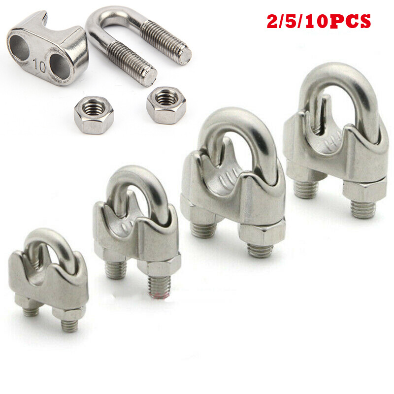

For my ensign, I attached a tiny block to my backstay using one of these
Works a treat
