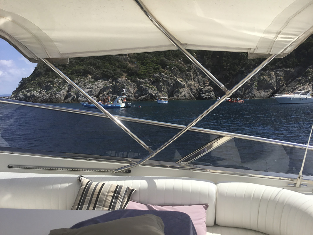

30 centimetres of chain is useless .
So you are right asking for advice.
Here are some pics ,
I,am in 20 M with 70 M of chain ( not sure how much the wife put put , but in the interest of matrimonial harmony, we aren’t dragging so I did not check :))
The smaller day boats had 3to 6 M of chain on a rode ( rope ) .
Clear water snorkelling told me this .
Due to the calm conditions , the same a you are specifically asking that seemed ok .
All the chain was sat on the sea bed .
So I would get 4/5 M or what ever you feel comfortable hauling and storing on the boat and and get rid of the 30 cm and attach the 4/5 m properly with a proper connector .
It s not worth using a C clamp or similar to join 30 cm to 5/6 M imho .

Thanks portofino
You are right but im having the 30 cm of chain in order to tension anchor with the bow roller, Although if i can tension from shackle attached to anchor shank i will work as you said. Will try to put safety anchor lock through the shank.
